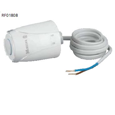

In my home i use an 230v actuator (fom moeller) connected to a X10 module (SAIX, Xanura) for every radiator. The complete central
heating system (12 radiators) is fitted with this solution.
Homeseer is controlling the radiators and gets the temperature info from sensors in every room.
Works great for already 2 years now.

You are suggesting to combine a radiator actuator with a SAIX12? But since my radiator is situated near a wall socket, is it possible to use a AM12 or LM12?
Where can I buy this Moeller 230v acuator?
Thanks again!
Re: Radiator control with x10
Yes it works with Those devices, saix is internal so for in a socket and is also 2 ways, so status control is available.

Am12 is indeed possible.
Just search for Moeller Xcomfort radiator valve on Google.
