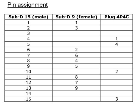

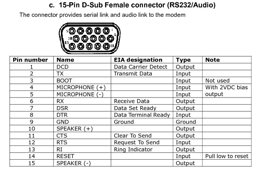

Excuse my English, I try to explain
I have a GSM modem that would connect the PM.
I know the designation of the pins of GSM, and want to know if anyone has a description of the pins on the PM for how to connect this GSM
Thanks
adapter to DB9 and 4p4c plug thelefone
gsm adapter.jpg (33.38 KiB) Viewed 5980 times
conections on GSM
conections on GSM
GSM conections.jpg (123.92 KiB) Viewed 5980 times

I dont think that will work, you can only connect a powermax GSM modem which will react to the powermax commands.
Not sure if the Powermax uses the standard AT commands, guess not. If you are really technical you can probably pull it off. As far as I know no technical documentation on this also, btw Visonic does even not have documentation on regular products :evil:
