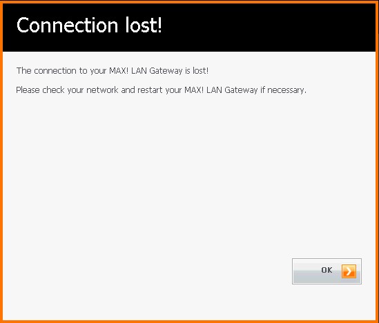

Re: ELV MAX! protocol description
I have 2 rooms with 2 thermostats so I think I can help.
But for now I have some other problems; and guess when it started?
Last "contact" was yesterday at 02:59:43; 17 seconds before... the clock was turned back 1 hour! !#$!$ :twisted:
Now the Cube simply disconnects within 5-10 minutes after connect... even the MAX app doesn't function anymore.
So for now, I have something else on my mind... :cry:
Post by mega »
Now my other 2 thermostats are here, so i can test it.
Have you tried to powercycle the Cube?
Max! 1 x Cube, 4 x Thermostat, 1 x Wandthermostat,1 x Fensterkontakt
Yep, dozens of times but no luck.
Tomorrow I'll revert to factory settings and start all over again.
