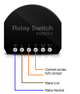

Perhaps a picture is better than words.
You will also need to configure parameters 3 and 4 on the FGS211. Parameter 3 to switch on the "Auto Off" feature and parameter 4 to set the "Auto Off Time".
NOTE: I have not tried the auto off feature on the FGS211 because I only have the FGS221 double relay. It works fine on the FGS221.
You can connect multiple devices to the N/O contact points. My video intercom is connected to the same point as the Fibaro.
Paul..
Paul..

I copied the picture of the FGS211 from the internet and then just added the coloured lines and connection info. Am I correct in thinking that you have the same colour wiring for a single phase system in Holland (Blue=Neutral) (Brown=Live) (Green/Yellow=Earth) ?
