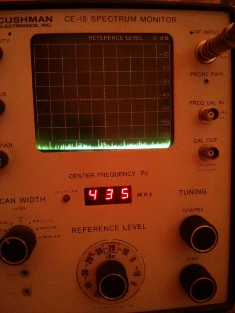

Update: someone was kind enough to let me use a spectrum analyzer. I've played around a bit with it and I do see a peak when i push the button on a kaku remote but apart from that: I don't know how to locate the source of the problem. Am I looking for a frequent peak ? Constant peak ? And on/around what frequency ? I'm a bit lost, even bought a new Cresta sensor but this one has the same problem: very poor reception.

If your friend has also a beam antenna connect this to the spectrum analyzer and try to find the RF source. The signal will increase if the beam is positioned in the direction of the RF source.
Or walk around with the spectrum analyzer and try to find the source. It is probably a very small signal of < -60dB

Re: Receiver problem
Post by piotr »
I don't know what a beam antenna is, this one has just a piece of coax connected. When I press a button on the remote it peaks to about -20db. I've walked around a bit with this machine but I haven't noticed any peaks. I've also asked around in the neighbourhood but there are no weatherstations etc nearby. My direct neighbour installed a wifi-extender but we've already ruled that out as the possible source. The neighbours on the other side started using a few kaku switches around the same time my problems started but that must be a coincedence. What would be the most probable cause ? I've googled on the subject and I've found a few stories about weatherstations with low battery.
