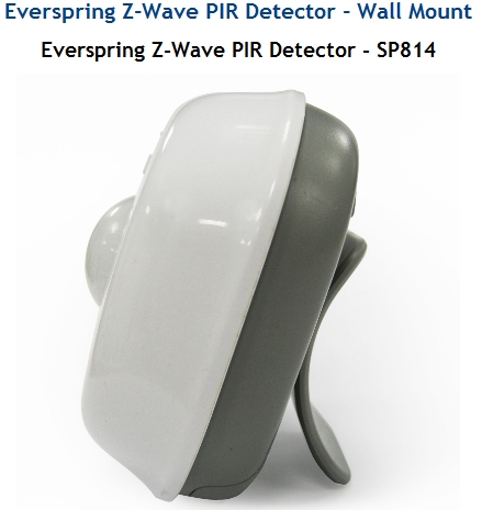

On this Everspring SP814, I found a picture taken from the side. Hmmm, it's design still 'leaves something to be desired' to put it mildly.
From the picture, it looks like it's not completely white on all sides all the way to the wall, which would make it ....strange.....
(the stand-up holder at the back I assume is from the webshop owner and not part of the product?)

Agreed. That is a pitty. I just dubble checked the manual, and I can see it there too. (installing batteries)
Once I had the Ez 3 in 1, and I think it was ok, but it's a very large device in depth I think. It's very "out there". These two are still the two I would pick of several evils :)
