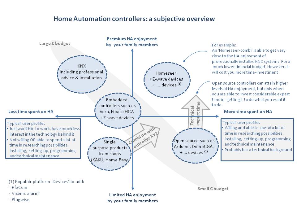

For those of you who are just beginning to research the options on Home Automation ("HA"), in particular which controller technology to base your installation on, maybe this overview-map can help somewhat. Mind you, done by a non-technical guy who places himself on the left side of this map.
My primary observations:
There's no 'one HA controller fits all'. Your choice of HA controller depends on where you make trade-offs between 3-factors:
(1) TIME: How much time are you willing/technically able to spent on researching, setting it up, programming, tinkering and maintaining your HA controller/platform?
(2) QUALITY LEVEL OF HA ENJOYMENT BY FAMILY MEMBERS: Your ambition level of how good the HA experience should be for your family members, not you!
The spouse & kids only care that it works, that it's easy to operate, that it is idiotproof and that is very stable without any hassles for them. Don't underestimate how difficult it actually is to achieve an high quality level in this regard! To me, it's better to have a limited application (remotely switch one lamp, for example) which works perfectly, rather than an extensive installation which crashes all the time or reacts very slowly.
(3) BUDGET: Your financial budget. A large budget can significantly reduce your own time-spent & increase HA enjoyment quality, but the investment can increase rapidly if you seek professional advice and installation help!
My own profile and my choice of HA technology
- I definitely sit somewhere on the left side of the picture. I'm not a technical guy, don't want to be and I don't want to spent too much time setting all the technical HA stuff up.
- My purchase of HA technology came before I realized the 3 tradeoff factors and I based my choice only on (2) ambition/quality, and a little bit on (3) budget. I can't afford KNX, but do want to achieve a similar level of premium HA experience.
- My choice was an "Homeseer combi" with RFXCom/Visonic + z-wave devices. Still an excellent choice versus KNX, but I underestimated the @#$! time spent getting it all set-up.
- If I was to start over as a beginner, I would probably start with Vera + Z-wave devices. And in a few years if I ran into limits with the Vera, would I switch to Homeseer. Again, remember my user profile when interpreting my statements!

Spot on! I really like your observations and agree with most of it.
For me the golden combination is Homeseer+RFXCOM where
- Homeseer gives you a LOT of flexibility to customize & integrate + a huge and active developer/support community
- RFXCOM lets you pick and choose the best-of-breed/best-price and easy to deploy solutions (easy because of RF).
Wired solutions are great but usually expensive, less customizable and eh.. expensive.
Quite often I am asked to setup systems for other people. I send them elsewhere because the fantastic system works great but does require a lot of technical knowledge and time to continuously maintain/operate/fine-tune.
Frequently the complex structure of my events, devices and scripts reveal bugs in situations I had never thought of (both cars gone before 10am but 1 returning just after 10am did *NOT* switch my heating back to 'normal': working in a cold house until I found out after 5 hours ;-)

Nice overview. For those reading this, I can add my personal experience.
I started off with a Homeseer/Xanura/RFXCOM/Plugwise. However the bottleneck each time was the stability of Windows, mostly in combination with USB controlled HA. Also because I thought KNX was too expensive to start with.
Now I have a working KNX Powerline setup (because it was too late to put bus cable everywhere). The price I paid for this setup was not much more then my first Homeseer setup.
The setup for KNX is as much a hurdle as understanding how to manually configure an IP network. If you know how to number things and how the structure works, it is practically the same as setting up a Xanura network (or IP network). The books helped me understand this.
Now I notice I have a far more stable network (with exception from the Plugwise part), which has so many modules and options available within Europe. For example, I'm getting a new airconditioning next week, I could integrate it in Homeseer using and IRtrans and sending signals for around €150, but only 1-way communication, and in addition to that I would have to spend more money if I would like to know the temperature in the room. For the same price I now by a KNX module which allows extensive 2-way communication. I can read settings, sensors and get error responses, I can set all main settings, scenes and more.
Also a lesson I learned is about estimated lifetime for a system. A friend of mine with a KNX setup (installed almost 10years ago) wanted to control things with his iPad. Just installing a KNX IP gateway of around €100 gave him full control of his "old" system. That won't work so easy with Xanura or similar products.
If I could turn back time, I would definitively go for KNX. As price was not that much higher in the end, and the hours spent would have been far less then with Homeseer/Xanura after all.
