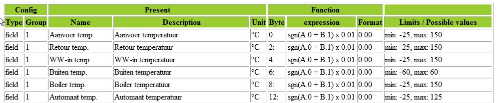

Below a very small part of how the xml is displayed with use of the xsl:
Capture_01 2012.02.19 14.25.36.jpg (75.43 KiB) Viewed 5969 times
