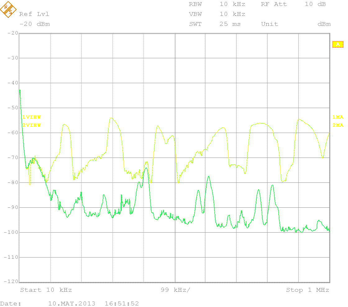

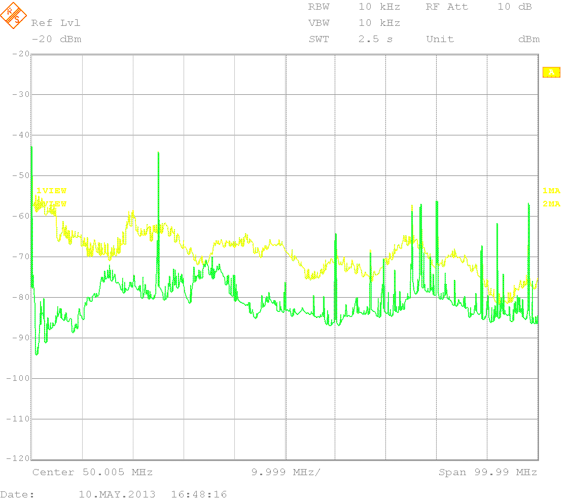

The GU-10 fitting compatible 230v LED spots eliminated the transformer and the difficulties those bring along. On top of that, the fixtures are a little bit cheaper too. So yesterday I fitted two fixtures. They both came with three halogen spots of 50Watt each. That seemed a bit excessive, so I bought three Calex branded LED spots.
All worked fine, until this morning: The lights no longer switched off. Or it switched off 30 seconds(!) later, or it switched off an on a couple of times, stopping randomly on or off. Now I'm not new to X10 interference, but I was pretty sure I have repaired all of my Xanura module's internal power supplies. So I was postponing this elimination diagnostics for later, until I realised it may be the new LED spots themselves causing the problem. Especially because the lamp had no problems switching on, only switching off. Removing the lamps from the fixture immediately cured the problem. Putting in the three standard 50Watt halogen spots that came with the fixture did not reintroduce the problem, so the LED spots are the cause.
These LED spots too have internal switch mode power supplies. And to keep coils small, they often operate at high frequencies. So I decided to dig a little deeper and measure the radiation they produce. I was flabbergasted:
Calex LED spot emission
Calex - Wide spectrum.png (45.95 KiB) Viewed 23509 times
The green line indicates background noise levels with the LED spot switched off. The yellow ling indicates measured noise with the LED spot switched on, hence the difference between both lines shows the noise introduces by the LED spot.
Almost anywhere below 100MHz, it emitted well over 10dBm!
And below 10MHz it's even worse:
Calex LED spot low emission
Calex - Low spectrum.png (43.4 KiB) Viewed 23509 times
Under 10MHz, emission above 30dBm are no exceptions. And my measurements have very poor coupling; I'm just using an antenna to pick up the emission. If I would use conductive coupling - which I won't, because connecting my spectrum analyser to mains makes me nervous - figures would be MUCH worse.
I wonder if these lamps were ever tested for EMC requirements by CE. And I wonder if there are any less-poluting LED spots in the market. I will try to bring these back to the shop tomorrow: €15,95 is a bit too much for lamps I cannot use.

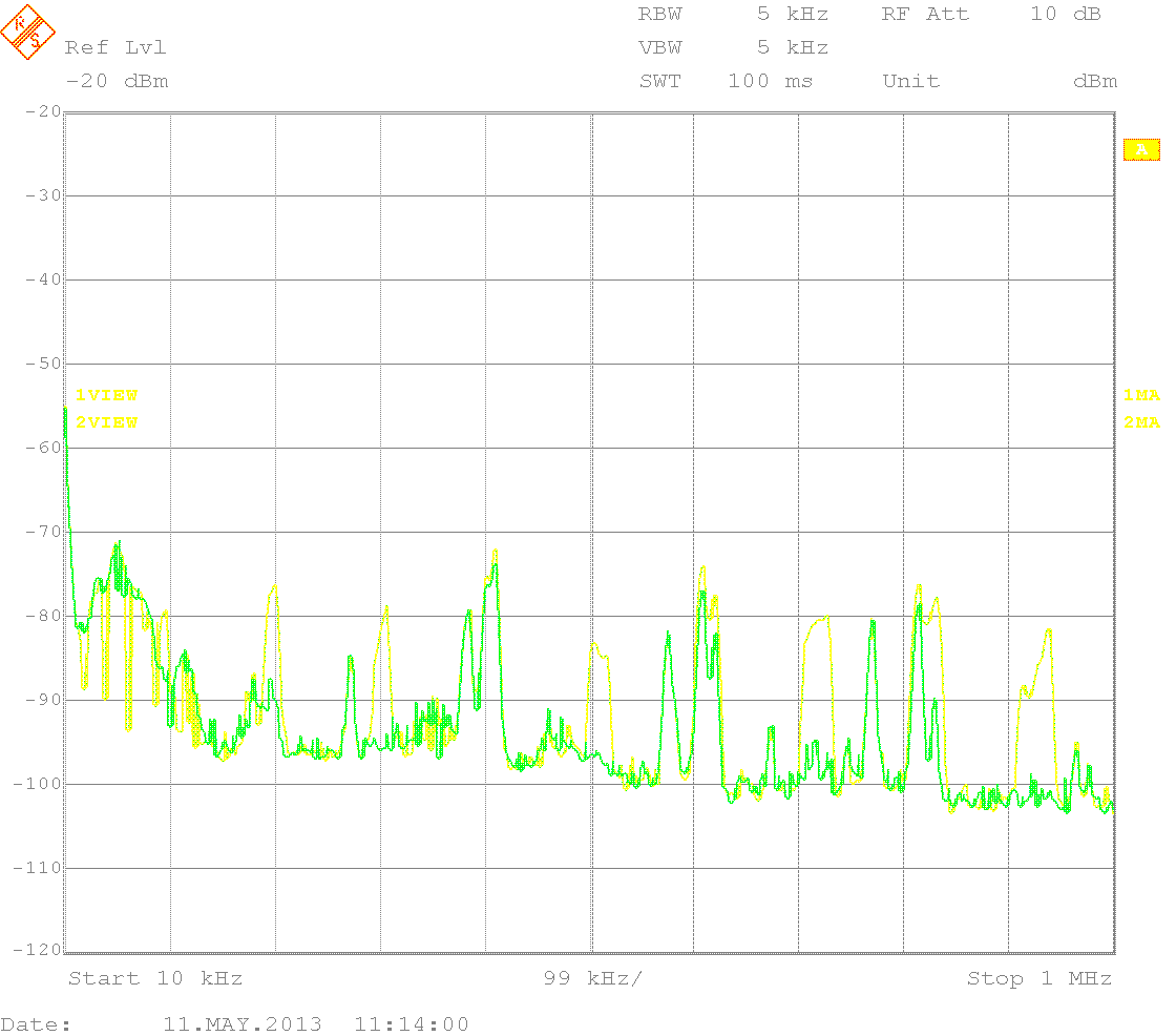

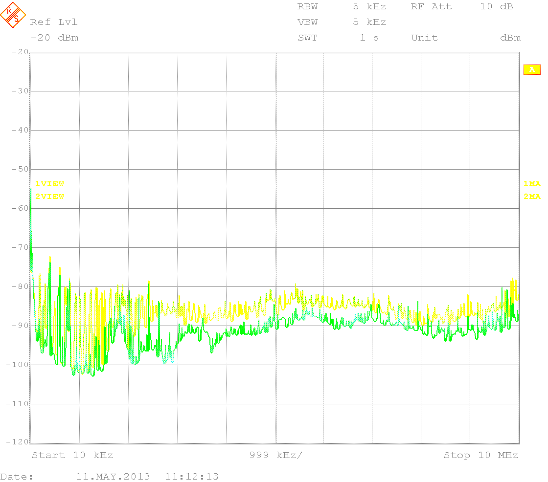

Fortunately I was able to return the Calex spots for a full refund. My local electra supplier recommended my Philips Master LED spots. So I installed them and those seem to work with X10. I'm not dimming them, only switching, but it looks promising. I'll have to wait a bit though, because the Calex spots started acting up half a day later.
Three observations:
1. Philips Master LED spots show an after glow after being switched off. This is not actual glow, it's the internal power supply buffers discharging on the LEDs. This is a good thing, because it smoothens light output, smoothens power consumption (hence reducing interference) and extends the LED's life. And cosmetically it think it's a nice touch.
2. Philips seems to take CE required EMC regulations seriously. Instead of putting on a CE mark and hoping for fall-out to stay away, they really investigate, measure and improve their product: http://community.lighting.philips.com/thread/2256 (See the presentation attached to the thread)
3. Emission is almost non-existing. My 10kHz to 100MHz sweep didn't show anything on top of the noise floor.
From 10kHz to 10MHz, some noise is visible:
Philips Master LED spot emission, 10kHz to 10MHz
Philips Master 10kHz-10MHz.png (47.28 KiB) Viewed 23494 times
From 10kHz to 1MHz, a couple of notches are visible:
Philips Master LED spot emission, 10kHz to 1MHz
Philips Master 10kHz-1MHz.png (45.37 KiB) Viewed 23494 times
A couple of small notches of 10dBm appear at 200kHz, 300kHz, 500kHz and up, but the area used by X10 - the first vertical column in the second illustration - is completely clean.
