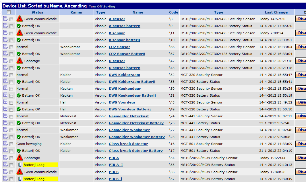

For the past few days I'm experiencing a curious problem, my RFXCom Homeseer Plugin keeps finding new security sensors (Visonic?) that I don't possess..
What could be the cause of this peculiarity?
- I don't use any other security sensors than Visonic
- To my knowledge, my neighbors have not bought, installed new sensors in the last few days
Background info:
First time I noticed this was a few days ago when I added some Visonic sensors. But the list of to be added sensors was longer than what I have in number of devices.
Just to be sure I didn't miss any, I added all these sensors to my Homeseer. Please see below the STATUS page within Homeseer. The ones which names like 'A' or 'B' or the ones unknown to me
what they could be.

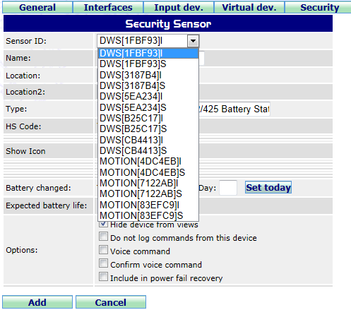

Then this afternoon, just to check, I noticed a new list of available sensors which could be added to my Homeseer. Please see 2nd attachment.

- Status screen.png (126.21 KiB) Viewed 4225 times
- RFXCom plugin Add Security sensors.png (28.11 KiB) Viewed 4225 times

Re: RFXCom keeps finding new Visonic sensors that I don't have..
Don't add sensors of neighbors. Or remove the antenna from the receiver to make it less sensitive;-)
Disable X10 if you do not use X10 RF.
You should ignore unknown sensors received which is always possible.
The procedure to add a sensor in the Homeseer RFXCOM plug-in is:
Click the CLR HEARD button,
Trigger the sensor to add,
Click the ADD button and almost sure you will only find this sensor now.
