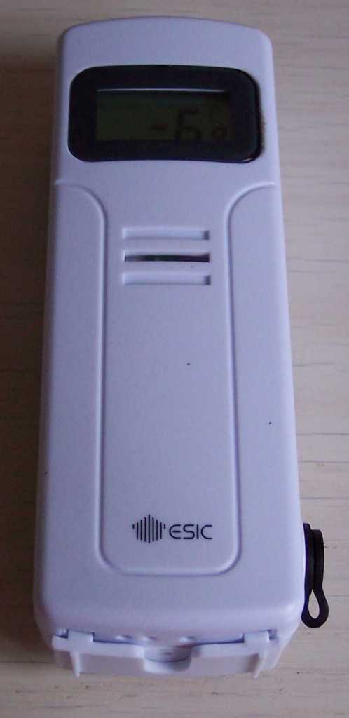

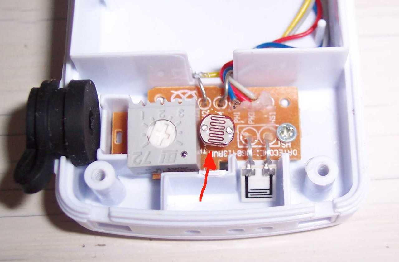

Hi, I needed something similar. I wanted to measure the sunlight level to have some additional rules for controlling awnings.
I took a cheap temp/humidity device from UPM/ESIC and modified it with a light resistor instead of the thermo resistor. In the picture below you can see that I also took away the connector for external sensor and instead added an adjustable potentiometer for tuning possibilities.
Of course your readings will in this case be in temperature so you need to have some code handling this. Maybe the humidity sensor could be replaced instead giving you a percentage value.
I think also the potentiometer could be replaced if you accept to tune the thing using some kind of covering for the sensor like a piece of (white) plastic tape or tipp-ex.
