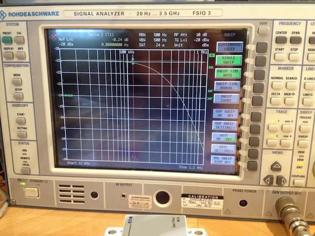

I'm having my fuse box replaced next week, and getting in that SFX40 filter that's been laying around here the past 7 years may be a bit harder than expected; All my extra wishes are making it a real tight fit. I've been doing fine without it for 7 years, but I would have felt better during these years if it were installed. Now to determine if it actually makes a difference, I have attached it to my signal analyzer and I came to the rather shocking measurement below:
Xanura SFX40 filter spectral diagram
SFX40 @120kHz.jpg (124.83 KiB) Viewed 6683 times
This diagram shows a the spectrum of the SFX40 filter under test. The left-hand side represents 12kHz, the right-hand side 1.2MHz, everything in between is scaled logarithmically. The green trace represents the input signal to the filter, the yellow trace the output signal from the filter. The red vertical line indicates 120kHz, where the X10 carrier signal is. The difference between the green and yellow line show the actual attenuation of the filter at the given frequency. I have put markers on both traces and the difference in printed in yellow: At 120kHz the SFX40 filter attenuates an underwhelming -0.24dB. That's waaaay too little (I feel the need to add more a's here, but I won't) to be of any use.

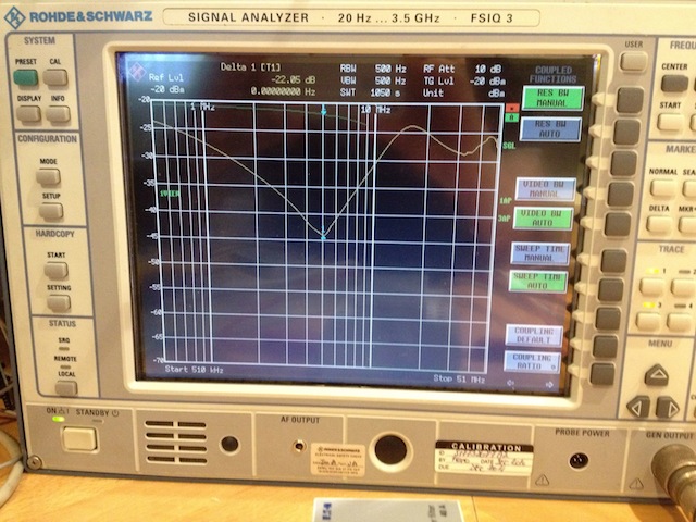

But at 2kHz and further, the output signal takes a dive, so I figured I'd see where it goes:
Xanura SFX40 filter dip
SFX40 @5MHz.jpg (122.51 KiB) Viewed 6683 times
I have to give it to them: It goes deep. Impressively deep even. But at 5.030MHz a whopping attenuation of -22.08dB is completely useless to block X10 signals at 120kHz.
I wonder how much engineering and testing went into this filter. Perhaps it's not possible to design a filter capable of handling 40Ampere that blocks 120kHz at a decent rate without introducing huge amounts of 'blind current'. But it is useless the way it is now, and a simple test would have proven that during development already. So I really wonder why it's on the market.

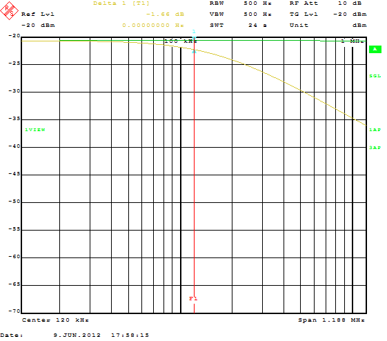

I have just pulled an AFX2 filter and measured it. It's not doing much better.
My AFX2 filters are modified, mainly because they didn't do anything at all. Internally they seem pretty standard common mode filters. But both windings have been put in parallel, and together they are in series with the load. My modification is nothing more than putting both windings in series. I doubt if it can still bear a 16A load with this modification, but at least it's improving X10 reliability near specific equipment, so it must be doing something.
Unfortunately I don't have any standard AFX2 filters laying around. And after spending a whole saturday figuring out how to connect my signal analyzer to my network, I felt too lazy to un-modify it for these measurements.
Xanura AFX2 filter spectral diagram
Modifed AFX2 @120kHz.png (28.84 KiB) Viewed 6642 times
Again the spectrum of a modified AFX2 filter under test. The left-hand side represents 12kHz, the right-hand side 1.2MHz, everything in between is scaled logarithmically. The green trace represents the input signal to the filter, the yellow trace the output signal from the filter. The red vertical line indicates 120kHz, where the X10 carrier signal is. The difference between the green and yellow line show the actual attenuation of the filter at the given frequency. I have put markers on both traces and the difference in printed in yellow: At 120kHz the modified AFX2 filter attenuates -1.66dB. That's not much, but enough to make a difference. I'm assumed here that an unmodified AFX2 does about half of this, around -0.85dB. Not a lot, but it could be enough in some case. In reality it's a bit more complicated than dividing it in two, but I think it's a good estimate.
And again a sweep to see how deep the rabbit hole goes:
Xanura AFX2 filter dip
Modified AFX2 @5MHz.png (27.2 KiB) Viewed 6642 times
Again the filter dips around 5MHz: -26,56dB @5,029MHz.
