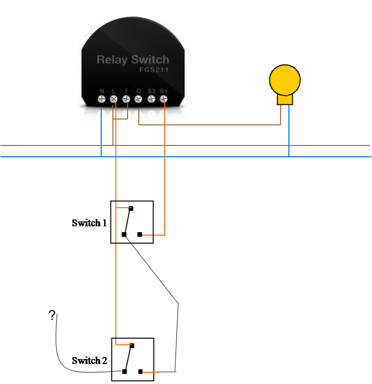

Having the single switch working for some weeks now, I also try to get a "Hotel Switch" working with a fibaro switch. Now this is really getting me stressed.
So I have two existing hotel switches build in the wall. In only one of them I have room for the Fibaro switch FGS211 3watt. Now As I understood correctly it would be possible switching the lights with one fibaro switch.
So I have the first switch on S1 and added the wire coming from the 2e switch on S2. The result = this is not working.. ?
Do I have to remove the wire on the second switch which is going to the light bulb?
Or is this wrong all together? Maybe someone managed to get this working and willing to share the experience?
I really appreciate having a schedule explaining how to wire this (clear for us dummies) or some foto's showing how its wired would even be better.

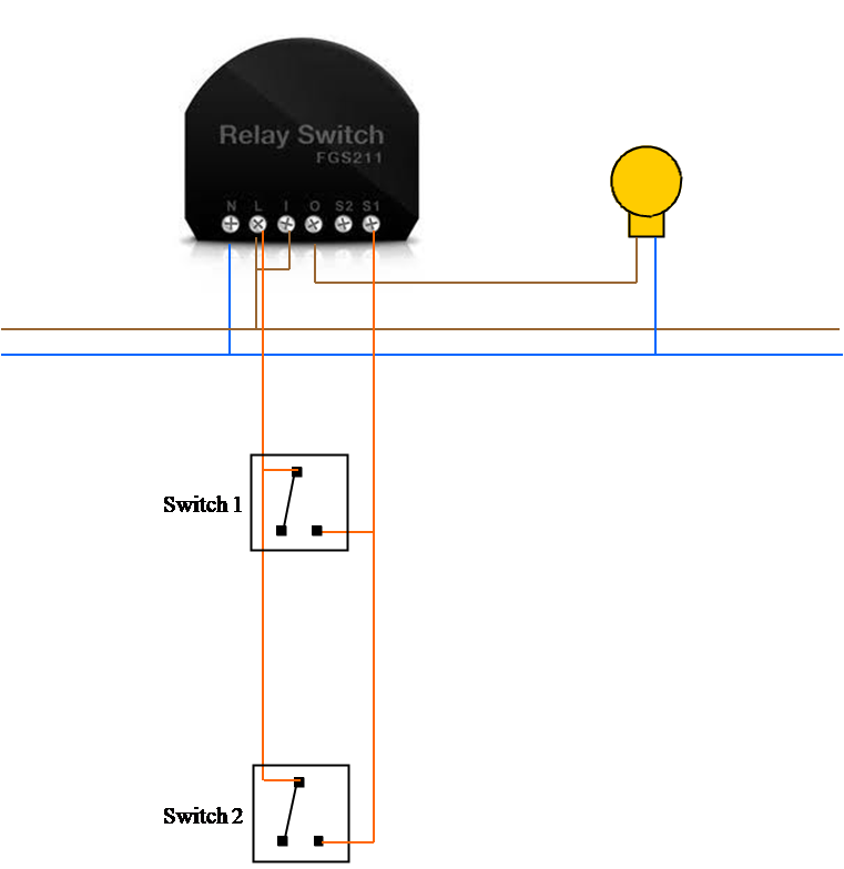

Re: how to install the fibaro devices
I can't see how the configuration in your diagram would work as you have 2 live wires going to the lamp.
This is how it should be wired. Brown=L Blue=N Orange=Switch
You can add as many switches as you need in this configuration.
Paul..
Paul..
Paul thanks for your help. I tried this and its working, but not the way I want. Now when I push switch 1 to on the light goes on. Than When I want to use the other switch switching it of again that's not going to work. So wat I wanted to achieve is that I can turn on and of the light with both switches no matter which one was used putting the light on or off.
So maybe I made a mistake or maybe the firbaro itself is not working properly. When all the wires in place and have the mains on, I could not get the fibaro included on my stick? (It fell on the floor from 1 meter hight so it might be damaged? I'm not sure).
So I'm a bit lost here

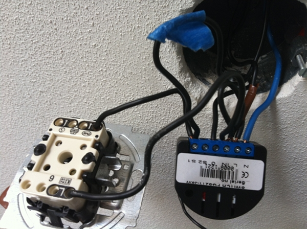

Geert-jan thanks for sharing your "dreams" with us
Since I live in an somewhat older house I have the traditional bi-stable switches installed. See attached picture.
The blue coded line comes from is from the second hotel-switch
Just took a quick look on the picture.
In the picture I see only 2 wires connected to the switch. I looks that you wired it according the figure some postings above; this wiring scheme works perfect for mono-stable switches, but not for bi-stable switches. In a hotel/wissel-schakeling a bi-stable switch is used and 3 wires are connected to each switch. See the link above, or just google on hotel/wissel-schakeling.
You will need two wires from the second switch that needs to be connected to the first switch, and one wire from the first switch should go to the Fibaro. A bi-stable switch has markings how to connect these wires (but this assumes that you know how to read the markings).
