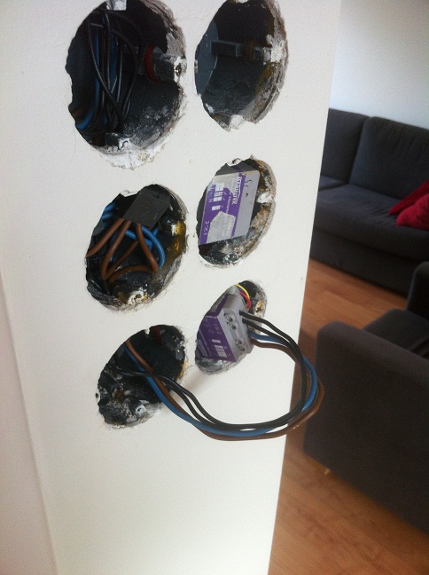

I have 2 marmitek lmm32's in 2 seperate boxes next to each other, see attached picture. The issue is when one of the 2 is turned on, the other doesn't work. It doesn't mean in which order. Here is how i have configured them:
lmm32-1: A1 & A2
lmm32-2: A3 & A4
So when either A1 or A2 on lmm32-1 is switched on, then A3 & A4 on lmm32-2 do not respond on any command (also not on all units on/off). And the other way around, when A3 or A4 on lmm32-2 is switched on, then A1 & A2 on lmm32-1 do not respond (also not on all units on/off). The strange thing is when both units are off, and i send all units on, they both switch on, and with all units off, they switch off. Strange right? I have a 4 other units around the house and they work fine, even when one of the lmm32's is switched on. I can't lay my finger on what it can be. I do have multiple phases coming into my house, I have my setup on 1 phase. Could it be that the modules are placed to close to each other, that they block each other's signal? I also tried different transmitters/controllers and have also swapped the modules.

its known that marmitek gives problems when they are to close to each other.
try for a test to enlarge the disctance........
