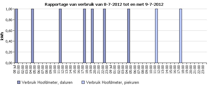

Two days ago I've installed the Smile P1.
It's connected via lan cable to my network. I've also a stick and two circles.
The circles working fine for several months and also the Source software displays all statistics very fine.
Now with the Smile, I experience that the realtime usages (in Watt) are oke, but the Source doesn't display every hour usage of the energy meter.
I can see the realtime usage for both energy and gas meters, so that's oke, but the hour statistics are updated from time to time. Every 6 hours an update is 'normal', see attachment. The hour usage is also every hour exactly 1 kWh. This values are different than in real live.... I don't have 1 kWh per hour usage at night.
The Gas meter update is normal, and it's only updated when there is usage ofcourse.

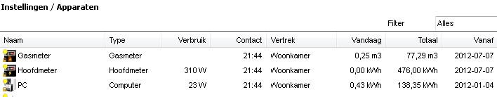

As you can see in the Device attachment, for the 'Hoofdmeter'= energymeter, there's no totaly day('vandaag') usage, only a current usage.
For the gas meter the current and day usages are displayed.
I deleted the energymeter and gasmeter two times and add them via the configuration wizard twice, but no solve.

The answer from Plugwise helpdesk is quit simple and also logical....They guess I've a 'slimme meter' that only handle rounded kWh digits. That's true, my meter don't display decimals in the kWh data.
So, if the kWh package from the 'slimme meter' is updated to a new value(+1 kWh), the Source software displayed it as new energy usages in that hour.

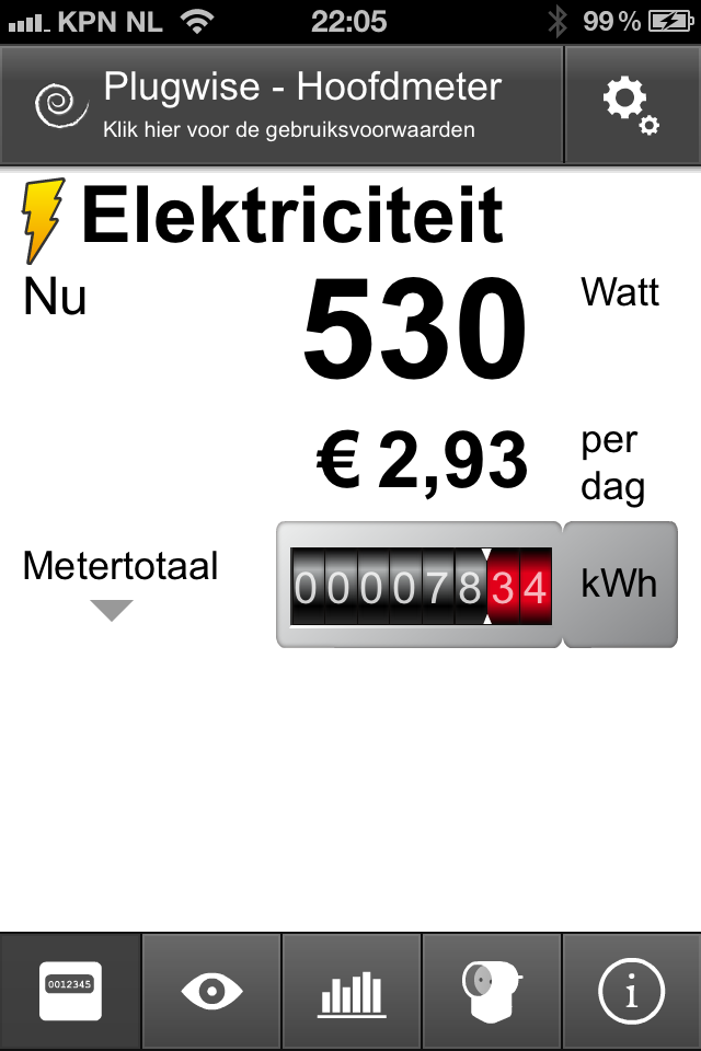

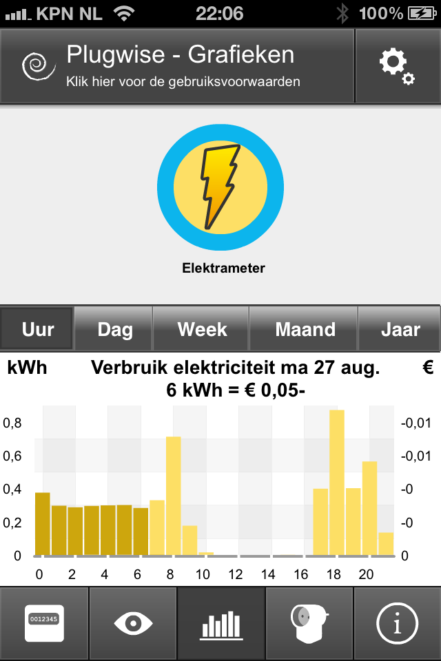

Also installed the Smile.
Idee and the app looks very promising.
Integration of the Source and Smile is also welcome..(not working at the moment)
App is very slow and will not work well outside your own network.
As reported before the app will show the power production in the main screen but will not show this in the usage charts.
Recording chart page my usage of today was 6KWh and it will cost me -5 cent..I do understand the calculation ...but I hope plugwise will display this correct in the next version.
Liander App works a bit faster and will do the same job ..(This app is also from plugwise)
Lets wait for the next version of the app
