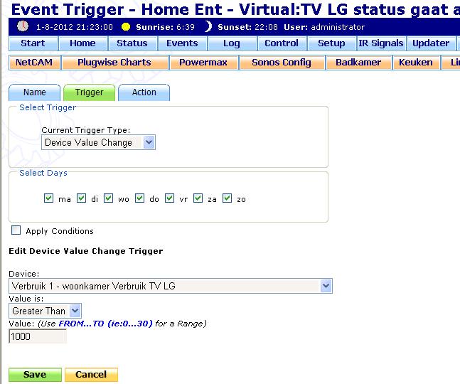

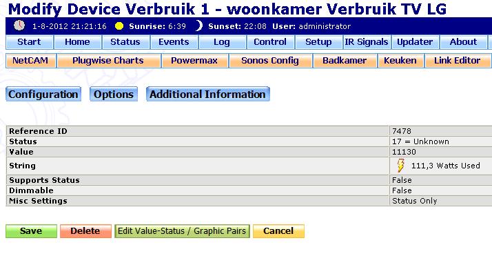

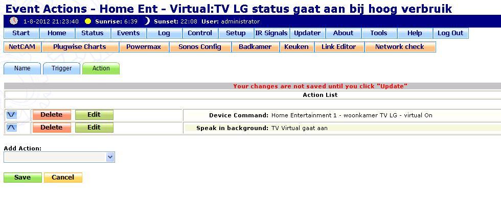

I have a similar problem. I want to switch a virtual device (tv) on when the power usage of an outlet changes above 10watts. The TV is plugged in in a zwave (greenway) powerblock which is being polled every five minutes (now) for the current powerusage. Of course I want to do opposite to.
I have made an event which I encluded in this post together with a screenshot of the powerbloks instance which contains the TV. My created event doesn't work.
* I used value instead of status
* watts is value devided so I used the value 1000 (which should equal 10 watts)
* When I use device value is between 1000...15000 it seems to work fine. But this runs the event every minute which feels unneccesarily.
I searched on this forum and the homeseer forum for two days and it puzzles me. What am I doing wrong. Events are hard to get the hang of
