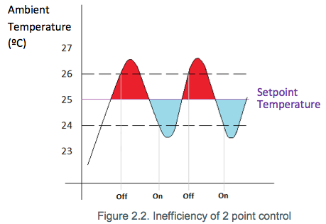

0,5C is not an unusual number for a regular thermostat. Looking at the attached image, all the red and blue is where the ambient temp does not match setpoint, could also be said to be the uncomfortable zones.
2-point graph
2-point graph
Screenshot 2013-04-02 at 15.47.15 .png (31.26 KiB) Viewed 15270 times
By adjusting the upper limit and lower limit you can decrease these "uncomfortable" zones, but it might increase on/off cycles (which in my opinion is not a problem).

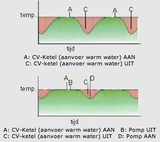

If you let the pump run for a while longer without adding more heat to the system the energy will be dispersed more evenly as you can see in this graph.
2-point with pumpswitch
Screenshot 2013-04-02 at 16.00.55 .png (57.49 KiB) Viewed 15270 times
It is not wrong, but just a different approach. You could compare it to your car: you can cut power to the fullpump and it will slow down, but I prefer to use the gaspedal and do it gradually. Depending on the luxury of the car and the skills of the driver the passengers will or will not notice the difference.
