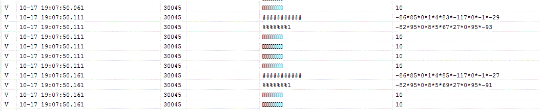

i bought this thing to explore the possibilities. you can control it with android or ios app color magic .
but i want to integrate it in homeseer.
i has a build in webpage which in which you can change the settings. (not documented. it says the port of communicating withthe app is 5000. this is a upnp port.
from my android debugger i get informatipn as mentioned in the attachment. a packet sniffer isnt working properly on my rooted htc.
is there anyone who knows how to read next values the columns are time pid tag and text.
the numbers are a result of pressing the on and of button of the led lights.
- screenshot
- Knipsel.GIF (16.39 KiB) Viewed 28550 times

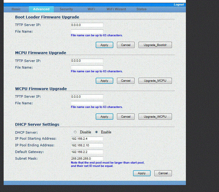

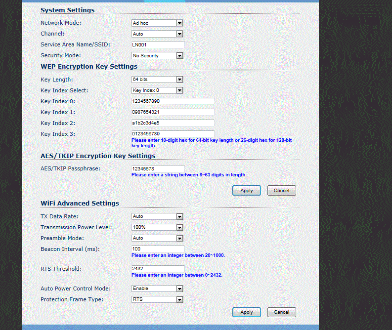

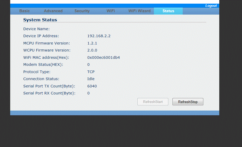

i have here the screenshots of the webserver of the leynew wifi led controller.
i think he communicates as a kind of comport on port 5000, and the controller can also be added as client to the wifi homenetwork

Re: wifi rgb led controller wf300 from leynew
should not be so hard to grab this. the webbrowser of this device is on port 5000. (http://192.168.2.2:5000)
so grab the webpage commands, like you did and take them over in a Homeseer script
no these pages are on port 80.
Ok I was not clear, the webpage to setup your device are on 80, but for receiving/sending the instructions its 5000labium wrote:no these pages are on port 80.
it has its own lan , but he should be able to connect to you home wifi network as client. i tried but now he is not in the air and has no reset button.
the info on the sites is minimal about this device, i dont know why this is. It even has no manufacturer name printed on it.
i opened it to find a reset button but no not available how so ever.
i will concentrate on techniques to send serial data over ip , digi is a good example with its serialport servers . i found some vb projects to do this.
the wifi interface is based on a WM001S version 3

The webserver is password protected what are the username/password?
EDIT: it's admin/admin
Has anyone yet figured out how to reset the webserver, via serial?

Does anyone manage to reset it? I have a wf100 without usb/rj45 or any suitable interface.
I logged into it via the web interface and tried to connect it to my home WiFi network by changing it from AD-HOC mode to Infrastructure and after a reboot I cant get to any interface anymore... Only the RF remote still works...
Any suggestions howto reset it?
Good evening! I had the same problem. But I have solved this problem. Download program "MyPublicWiFi", install it, and create a virtual WiFi hotspot with the SSID name and encryption settings the same as you have in the controller. I had a network name "LN005" encryption - AES with key 12345678. The settings I entered the program "MyPublicWiFi" and created access point. The program in the "Clients" tab after a while I found connected to said network controller with IP address 192.168.2.2. After that, I open a browser and get access to it.
I hope this helps you.
