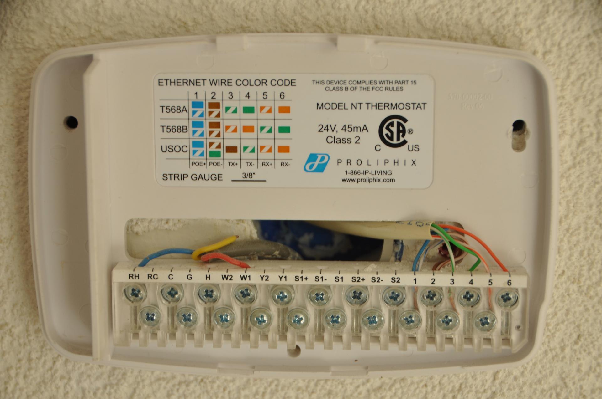

I made some pictures recently when I removed my NT20e, as you can see I also use RH and W1:
And you're right, don't take any risks you don't want to, that's better for your equipment :wink:
