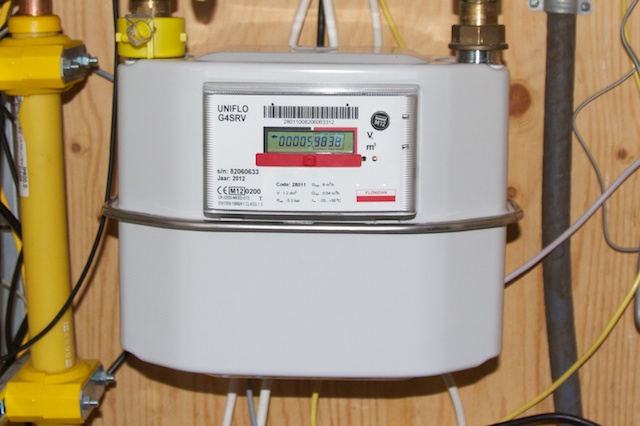

Gas meters depends on the supplier and vary from place to place. Mine has a wireless connection to the smart meter
Smart 002.jpg (83.58 KiB) Viewed 25792 times

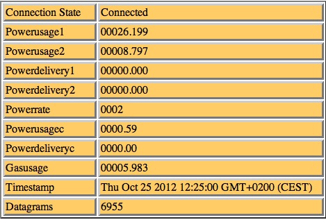

My websockets based meter - you can see the gasuage equals the meter reading

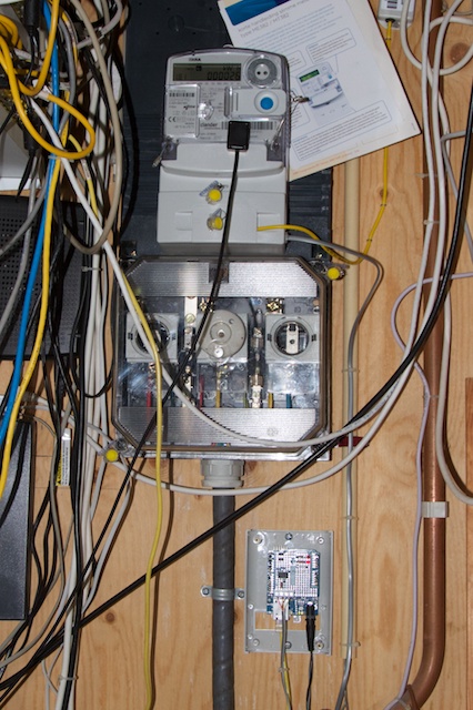

The Iskra meter and the arduino interface - software available at Github
Smart 001.jpg (141.72 KiB) Viewed 25792 times

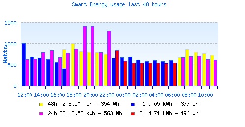

A graph showing the tariff mode and usage for T1 & T2 over the last 48 hours at 17:00 you see a yellow bar stacked on a blue - at that moment the proper settings for T1 and T2 have been loaded into my smart meter. Blue and Red bars between 23:00 and 07:00 for T1 mode ( nacht / weekend ) - let's what it shows over the weekend.
Re: My Smartmeter Install
Thats the graph we want!
My new installed smartmeter is still on T1, have to wait till monday :)
btw: what are you using for generating the graph

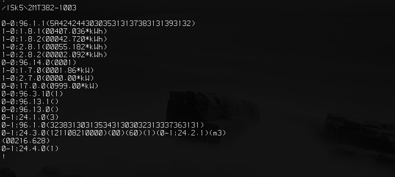

Well, just new here. Also have a smartmeter now and have figured out how to read it using an FTDI cable and the P1 port.
ISKRA MT382
ISKRA MT382
Schermafbeelding 2012-11-08 om 21.00.14.jpg (66.74 KiB) Viewed 25574 times
Have bought already an Arduino board (Mega v3) with ethernet shield as I would like to run a webinterface on the Arduino. So, data from P1 port into Arduino, process data and display via IP on other devices. Still looking for that Arduino software (have no experience al all with Arduino)
