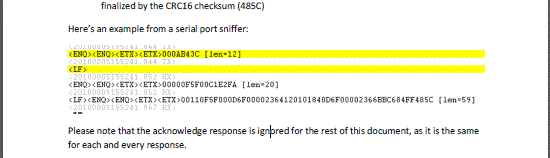

i saw some portsniffer results on plugwise on the web, but why are ascii characters used and not the hex or byte representation ?

Because they can have a special meaning. STX=Start of text, ETX= End of text, LF=Line Feed etcetera.
Some people prefer to see LF instead of 0A.
I know that sniffer, you can turn it off if you want to.

I compared my results with that of mister damen to see if it works and i noticed his sniffer uses ascii characters i have simple bytes.

Because ASCII is what the device ´talks´. Most PlugwiseDevice messages are ASCII coded Hexadecimal digits. Also the relevant protocol mesages are between a start marker and an end marker. That way it is easier to find the relevant messages for the receiver.
Plugwise also sends some other messages, but they seem not relevant for the software, more debugging hints... You could switch the sniffer to all HEX output where each byte is coded into two hex digits, but that makes it more difficult to see what is going on, as the device talks mostly ´readable` ASCII.
Here a small example of the raw code the sniffer outputs...
83  20:37:28  PlugwisePC.exe  IRP_MJ_WRITE  VCP0  Length 14: ....000AB43C..
88  20:37:28  PlugwisePC.exe  IRP_MJ_READ  VCP0  Length 83
88  20:37:28  SUCCESS  Length 83: ....0000000100C1FEED......00110001000D6F0000B835CB01018A0D6F0000B1B64B3B8AFF75CC...
90  20:37:28  PlugwisePC.exe  IRP_MJ_WRITE  VCP0  Length 30: ....0023000D6F0000B835CB5C5C..
94  20:37:28  PlugwisePC.exe  IRP_MJ_READ  VCP0  Length 47
94  20:37:28  SUCCESS  Length 47: ....0000000200C1103F......00240002000D6F0000B83
Where an ASCII is not 'printable' you see a dot ( '.') and other messages from the capture process.
Here an example of some other messages in the stream
390  20:37:39  PlugwisePC.exe  IRP_MJ_READ  VCP0  Length 36
390  20:37:39  SUCCESS  Length 36: ....0000001C00C1E248..# APSRequestNo
394  20:37:39  PlugwisePC.exe  IRP_MJ_READ  VCP0  Length 96
394  20:37:39  SUCCESS  Length 96: deInfo: Source MAC: 000D6F0000B835CB# APSRequestNodeInfo: Destination MAC: ..000D6F0000AF65AA...
Here a debug message`# APSRequestNodeInfo: Source MAC: 000D6F0000B835CB` is in the stream (and another one `#APSRequestNodeInfo: Destination MAC: ..000D6F0000AF65AA...`)
What bytes are send for the dot´s is unknown in this capture.
