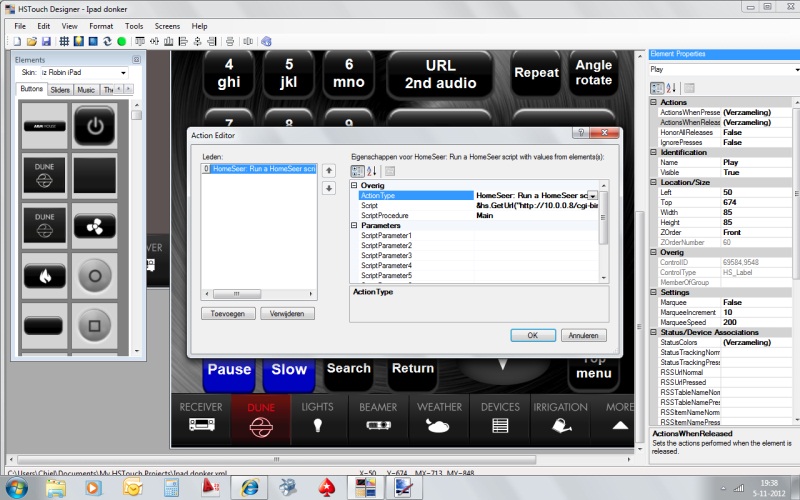

I use &HS.GetUrl.
Run a Homeseer script with values from elements
In the script line i put something like this;
&hs.GetUrl("http://10.0.0.8/cgi-bin/do?cmd=ir_code& ... "",True,80)
This one is "PLAY"
No seperate scripts, just one line.
Easy.
