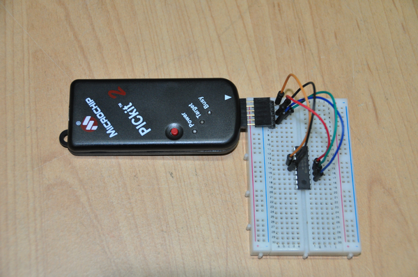

Maybe this can be useful for those who want to program the PIC for the Opentherm Gateway themselves with a PICkit 2 or -3 programmer:
With a small breadboard and a few wires you're done in 3 minutes:
And here the document on how the connection need to be:
icsp-info.pdf
