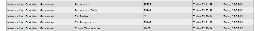

While looking at the incoming information from my Opentherm Gateway, I saw something strange today.
Here's a small piece of the information:
Capture_02 2012.11.10 22.36.20.jpg (24.63 KiB) Viewed 4056 times
The number 65535 immediately caught my attention, for the obvious reason - can't be a coincidence, right.. :)
So I had a look at the information from my Remeha Recom Interface, this one told a completely different story:
Capture_03 2012.11.10 22.39.15.jpg (10.83 KiB) Viewed 4056 times
My first thought was that there must be something wrong in my Opentherm Gateway frame decoding, but that was not the case.
The fact is, that Opentherm can only handle 16-bit unsigned values for the Data ID regarding the number of burner starts! (Data ID 116 (decimal), Type u16).
So if you're connecting the Opentherm Gateway to a central heating that has been operational for some years (mine: 3), you can expect some "strange" numbers!
So remember this; 16 bit is the max!
