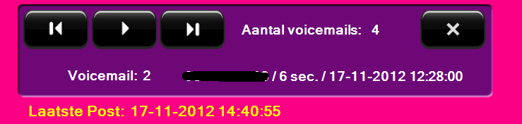

Now lets see if the Plugin is better too now, I'd really like to see your HSTouch screen :)
RdP
Posts: 989
Re: Version 1.0.2.0
Post by RdP »
I'm not yet ready and satisfied, but here is a first peek at the screen.
I'm not a graphical superhero, but it's easy to use and wife proof :D
I use HS scripts to handle all actions and it works... The only strange issue I have is that sometimes the .wav is played twice or even 3 times... I have to do some more testing to see if this is caused by the plugin or not..
/Rien
Re: Version 1.0.2.0
You probably need to debounce the buttons :lol:
Nice to see what's being made with the Plugin :D
