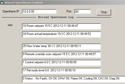

Not sure which Isense version I have, how can i see it?
Below workaround works for me now, but im not happy with it
If ID9 Remote override <> 0 then first send a TT=0
if ID9 is received this you can send the new setpoint
Downside is that the thermostat goes for few seconds back to its original program :(
