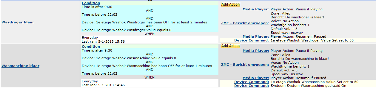

In my quest for the ulitmate laundry ready notification setup i think i have stretched it to the max, including the WAF.
This is what i wanted to accomplish.
Get an alarm and a announcement by speaker that will tell me that the washingmachine is ready.
That was rather straight forward and this is what i use for this task http://domoticaforum.eu/viewtopic.php?f=17&t=8008
Now the wet laundry can go two ways.
First it can go into the dryer. If so then i want to have also for the dryer an alarm and an announcement by speaker that will tell me that the dryer is ready. I use the same mathode as above for this one.
I don't want those announcement nagging me the whole time so then must do it it once and thats it.
This is accomplished by using different values for different states instead of just ON/OFF

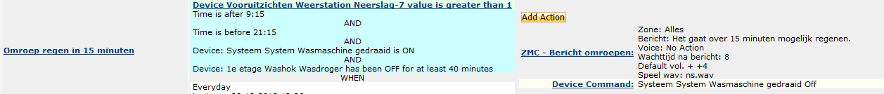

However at sunny days the wet laundry can also go outside. What to do about that?
Well, i've made an extra event that checks if the washingmachine have done its job and it doesn't mind that the washing machine is running again or not. The event also checks if the dryer is started within 40 minutes. If not then the wet laundry apperently went outside to dry (or still is in the washingmachine for that matter)
Now i have determined that the laundry is hanging outside i want it to get dry and not getting it more wet because of possible rain. At this point a great script from Alexander kicks in, named neerslag monitor http://domoticaforum.eu/viewtopic.php?f=47&t=7066
This script will give you a prediction of the amount of rain to be expected at your location in steps of 5 minutes. By combining these two i've setup an event that will check if there is rain expected in 15 minutes. If so then there will be an announcement/alarm and you will have enough time to get your laundry inside again.

Re: [Informative] Washingmachine ready DeLuxe or WAF to the MAX
Oke here the are.
These are the device that i use.
And these are the events
Note: ZMC is my media center pluginj that can also do the announcements. You can replace that with hs.speak
