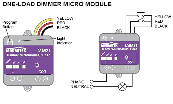

I want to control a Marmitek LMM21 using a Jung Impulsdrukker (type531, with 1-polig maakcontact).
How do I need to connect the black/yellow/red wires from the micromodule to the Jung switch?
I have tried every possible combination connecting the wires to the switch, but with no success. I can get the light turn on/off, but I cannot dim or get it brighter.

If you want to dim the light, keep the switch pressed for a few seconds.

I have got it working
On/off and dim/bright does work, but not in a way I want to have it working.
Only the top half my switch controls this all, the bottom half of the swith does nothing. By keep pressing the top half of the switch, the light cycles through dim and bright.
What I want is
- the top half of the witch turns the lamp on (single touch) and/or brightens the lamp (keep pressed)
- the bottom half of the witch turns the lamp off (single touch) and/or dims the lamp (keep pressed)
So your feedback is still appreciated.

That is only possible with a lwm1p micro module.

I have now replaced it by a DAIX12.
