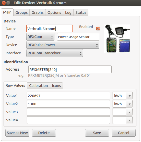

I'm using DomotiGa and RFXmeter.
For several weeks I'm trying to read the Power and Gas consumption.
I have no idea how to calibrate DomotiGa for a proper indication.
My meter gives 1000 Leds for a kWh...... So... 1 ledblink for a Wh.
What I got are two different values:
What I want is in Value 1 the actual number according the "orignal Nuonmeter" and in Value 2 the powerconsumption in a Hour.
That is the powerproblem. Still I have the GAsconsumption as well..!! How to fix this.. Same way?
Thanks
B

Within calibration tab you should be able to "fix" the Value1 for sure. Something like:
(Value / 1000) + <offset>
Then it will give your Nuon values.
Thx... After couple of calculatings and testing I have a proper indication....
