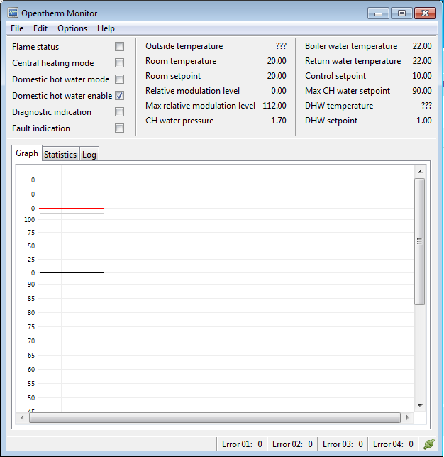

Recently i bought the OTG and the last days i'm playing with it.
I noticed that allot of figures and options are not working/available such as the central heating mode.
Does somebody known how to solve this?
Attached is a screenshot of my openthermgateway monitor.
hopefully somebody could help.
Posts: 2035
Re: OTG compatible with R8810A1018
You seem to expect to be able to click on "Central heating mode" and make something happen. That's not how it works. The left column only contains indicators that show the state of certain bits in the status byte. When the thermostat instructs the boiler to start heating, the boiler will confirm by setting the "Central heating mode" bit and you will see a tick-mark in otmonitor.

No, i expected that the ticks were indicators for the feature that are available to use with the OTGmonitor.
How could i use/force the OTG to let my CH begin heating?
Posts: 2035
The opentherm protocol is used with modulating boilers, so it's not just either on or off. You will have to decide how much you want it to heat. You can control that using the "Control setpoint" (CS command) and possibly the "Max relative modulation level" (MM command). Or you can go the more usual route of changing the room setpoint on your thermostat, if it supports that.
