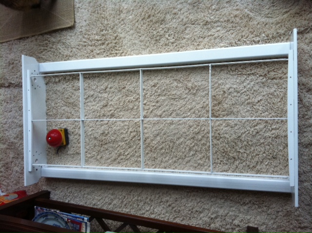

The Steel frame as i got it including the free stop button incase of emergency

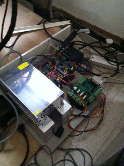

The electronics
3 x a power supply to drive the motors
2x48v 6.7 ampfor driving the big motors and 1x
1x30v for driving the nema 23 on the z-axis.
4 drivers, one for each motor ) black boxes
1 breakout board ( lpt )
The extra motor, driver, bearings, drive shaft makes the whole system more expensive, but that was my personal choice.

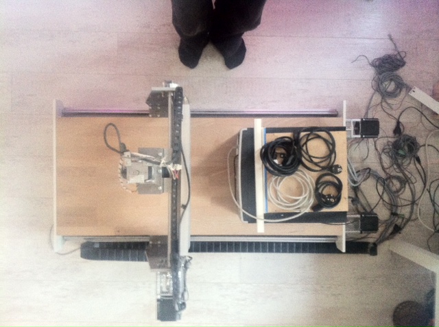

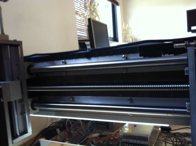

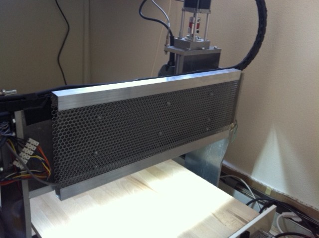

Here you see the machine in its almost finished state...
