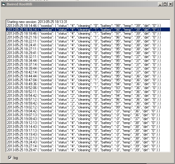

Together with Xavi from RooWiFi http://www.roomba-wifi-remote.com/tag/roowifi we created a TCP server which gives notification to a local IPnr Port.
This is running for now smoothly on Bwired, soon i will show the Roomba realtime online.
See also my blog on Bwired.nl http://blog.bwired.nl/?p=676
When the roomba is turned on or stops cleaning you receive below JSON, also there is a JSON hartbeat around every 2 minutes.
"roomba": {
"Status": "2 ", 0 Not Charging, 1 Recovery, 2 Charging, 3 Trickle Charging, 4 Waiting, 5 Charging Error
"Cleaning": "0", 1 if doing a cleaning action 0 if not
"Battery": "78", remaining percentatge of Battery
"Temp": "32", temperature in Celsius
"Dirt": "0" 0 if no dirt detected or 1 if yes
Its possible ro also send the Roomba commands via the tcp connection or via HTTP
http:// Roomba_Wifi_Remote_IP /roomba.cgi?button=CLEAN
http:// Roomba_Wifi_Remote_IP /roomba.cgi?button=SPOT
http:// Roomba_Wifi_Remote_IP/roomba.cgi?button=DOCK

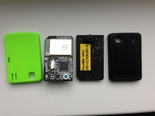

The green and black cover are printed with a 3D printer

i recieved mine today, and i noticed that the pcb is getting very hot. i removed the cover for some extra cooling
and every minute wifi signal is lost.
anyone else with the same problem?

i must say that the connection is stable now.
i removed the cover, the pcb is not so hot anymore, probably a heat problem
Re: RooWiFi Roomba WiFi control
Same here getting warm, this will be solved in next tranche i thought

mine is from a new batch
it is a heat problem, webserver is after a while slow and not loading completly. after a few minutes in my cooler: working as it should

I send you an email talking about it because was the first time that it happens: I detected an issue in some units of last production, it’s strange because anybody told me, maybe only part of this production has this issue:
After one day working and testing: The assembler has a mistake on mounting a capacitor that allows to manage better the temperature, with a diferent capacitor (less capacitance) the temperature of voltage regulator rises up to much and stops working because over-temperature detection is enabled.
Excuses because we test every RooWifi before shipping but not for an extended time to detect this bug. As I told is the first time that it happens and we want to talk seriously with the assembler and find the best way to verify it when the board is assembled.
Kind regards!

1. Is the (green/black) cover included in when you order the RooWifi?
2. How much height does the RooWifi add?
Akatar
Posts: 1135
Location: the netherlands
Post by Akatar »
mine was included, color green
i use mine without cover and it's 6 a 7 mm thick
