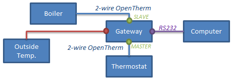

Thus I stumbled on the OTGW. It's one of only a few solutions I could find to control a OT heater. However, there are some things I can't quite get my head around. As I read it the gateway still requires a thermostat, or is this optional? Is it not a complete replacement for the thermostat, or am I not understanding the usage of the gateway correctly? My second question, and its answer may possibly solve my previous question ;-).. The gateway has no (header for) a internal temperature sensor? Finally, Does the PC has to be connected at all times, or can you just upload the rules to the gateway?
Attached is a quick draw of how I now understand the OTGW. I would like to hear what it can do in the average household, as I'm understanding it now, all functions can also be provided by a good thermostat.

You understand correctly. The gateway isn't a thermostat. It was designed to be used together with a thermostat. Controlling a central heating system in such a way that you get a comfortable temperature while still being as energy efficient as possible is much more complicated than it may look at first glance. Many years of research have been invested into getting that right by thermostat manufacturers. I didn't see the need to try to replicate that. In addition, a thermostat provides a nice interface that the non-geek members of the household are comfortable with to manually intervene with the standard program.
The gateway can be used to:
  • integrate your central heating with a domotica system.
  • remotely control your thermostat.
  • inform you via email or text message when there's a problem with your heating system.
  • provide smart power for a thermostat when the boiler doesn't support it.
  • clean up the opentherm signal if either of the devices goes too far outside the specs for the other device to understand.
  • connect an outside temperature sensor or provide the outside temperature to the thermostat from some other source.
  • automatically lower the thermostat setpoint when you arm the security system upon leaving the house.
If you don't need any of these features, or have a thermostat that can provide all the relevant features, then there's no reason to use the gateway.
Not all of these features require a PC to be connected. Also the outside temperature sensor is optional.
The 4.0b0 firmare will allow you to use the gateway without a thermostat. You then need a computer to instruct the gateway what to tell the boiler. This is done at a very low level. The computer needs to somehow determine how hot the water in the system should be. It can't just say it wants the room temperature to be 20 degrees (which you can with a thermostat connected). Note that I only added this feature because several people asked for it, not because I think it's a good idea.
