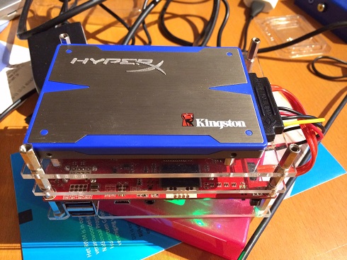

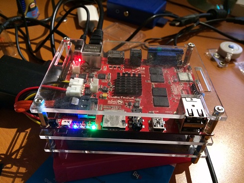

The big advantage of the Cubie against the Rasp is that its much faster and the SATA connector, this options makes it an independent Domotica controller / webserver.
I installed Ubuntu server and move it from the Nand memory to the sata drive (boot)

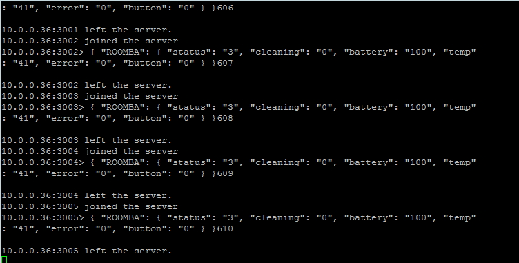

Example: Getting the status of my Roomba via RooWifi was easy to do, see below the json status coming in.
with the help of node mysql https://github.com/felixge/node-mysql its easy to log everything in a MySql Database which is also running smooth and fast on the Cubie

See below an example script which receives a Json string from the Roomba and stores it immediately in a Mysql database which is also running on the Cubietruck.
This is the only script needed for this! you can run it automatic when the Cubie is rebooted and even monitor it with Monit service manager.
With Node-Inspector you can debug everything via standard Google Chrome F12 function.
