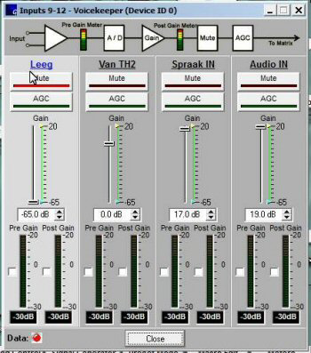

input9to12
input9to12
The image above shows the settings i use.
For now you are only intrested in input 12. This is the
input on the far right. Next you will see a rather impressive diagram of the inner workings of the XAP800. You will see a button
called 'inputs 9-12', click that one. Click on label 'input 12' and rename that one to 'Audio IN'. Next
check the checkbox next to the VU meter called <b>post gain</b>. This will give you an active volume level meter.
Start your media player with some music and watch the VU meter. Keep the gain at 0dB. Now use you volume
control on the PC to raise the VU so far that it is in yellow without going in to the red area. You might
need to adjust the gain on the input to get it right. For all levels it counts that they must never get
into the red area otherwise sound might get clipped.

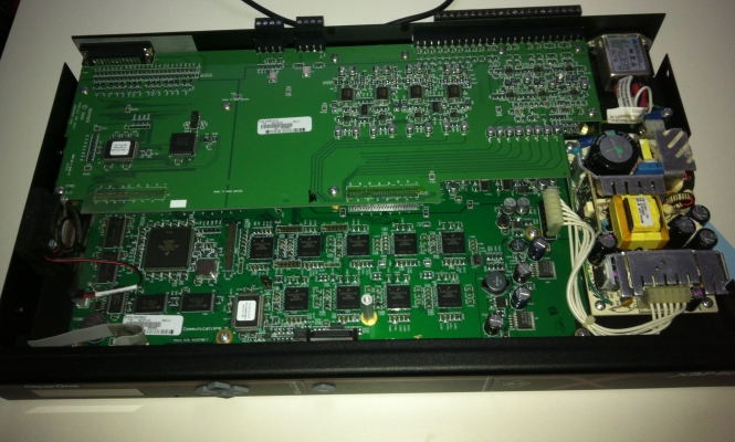

I wondered about the power usage the other day, because i'd seen discrepancies in the official documentation (Ranging from 15-30W.) So I hooked it up to the meter today and here are the results:
  • IDLE: 25,1W
    PLAYING 2 SOURCES to 2 OUTPUTS: 25,3W
So if you're using all 12 channels it'll probably be something between 25W and 30W. The fan is pretty noisy, might have to change it out for a new one. But the unit doesn't get very warm, just lukewarm on the side of the power-supply.

I have 3 units now. Two of them are nearly new, no scratches, no dust and the fan is silent. I had to open the case to check if it was working.
The 3th one, bought in an other auction had a very noisy fan. I replaced the fan for a new one found in the UK (don't you love the Inernet) :-)
A noisy fan will raise the power consumption slightly.

I was quite surprised how clean the unit was on the inside. Good to hear it can be dead quiet.
Did you replace the fan with the exact same one or just something else?

I did replaced the fan with the exect same model and type. I was lucky to find one also on ebay.
If i recall well it's a 5V, 8 Watt or so and a span between the screw holes of 80mm
