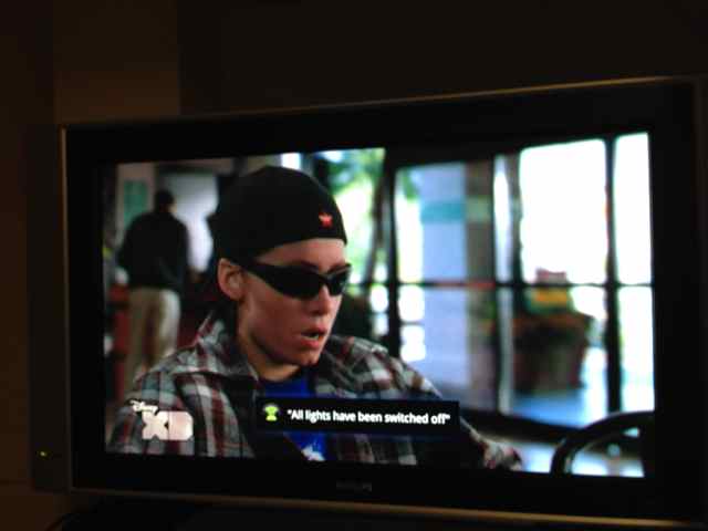

I was looking for a way to display all kinds of message on my TV screen when watching TV or any other input.
I read some post at several sources, but could not find a decent solution. So I began searching for a device with a HDMI in and output option and to make a long story short, I bought a Sony Google TV box (NSZ-GS7) (50 euro on marktplaats) and after trying some app's I finally choose "Notify My Android"(NMA). This app is not officially supported on Google TV but you can 'sideload' it and works without a probleem. You have to create an account on the NMA site and of you go. There are many ways to sent notification, so any domotica platform can interface with it. This was my first Android experience :roll: and I expect it to work on any Android device(but don't own any other) There are only growing Apples in my house :wink:
I just wanted to share this with you and if you want to know more please don't hesitate to contact me.....

Nice feature! Thanks for sharing.

Does it produce an overlay on the current selected input or do you have to watch everything (including TV) via the GoogleTV device in order to produce the overlay (I assume the latter)?

i have a dreambox tuner
so dreambox tuner (or other tuner) to the hdmi in of the sony google tv, hdmi out of the sony google tv to youre tv
i don't use the sony google tv, exept for the overlay.

Hmm, looks great, did u also try to run hstouch on that google tv box?

exactly !!!

Not yet, but I read this should be possible :)

Hi Rene,
Because you connect the Google TV box between your TV (HDMI out) and any input device (HDMI in) so in produces an overlay over the input device.
In my example the input was a Ziggo DTV device, but I intend to place the box between my Onkyo receiver and the TV. The Onkyo has 5 inputs and 1 output HDMI port.
/Rien
