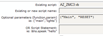

The ZMC RESET section contains the default setting for the system how I prefer it. You should use Gware and tune the various levels to your own liking and fill in the values in this section. Just in case you have to reset your system back to a state where you know that all sound levels are correct. A reset can be done with the command AZ_ZMC3.vb("Main", "RESET")

Each event calls the ZMC script with a command and provides parameters for the command to execute.

With everything in place connect to the XAp800 by starting the connect event (AZ_ZMC3.vb("Connect") )
This will open up the serial connection and enable the callback function. Your system is ready to take commands. At the start of the script you can find all implemented commands. For the daily use of audio system the following commands are used

To turn on make an event that will trigger for example due to a motion sensor in the kitchen. Let the event fire the script with AZ_ZMC3.vb("Main","KITCHEN;AAN;1080"). This will turn on the music in the kitchen for 1080 seconds (18 minutes). After this period of time the music will turn automatically off by calling the event '<roomname> music uit' event. If the triggers fire again in this period then the timer will be reset.
The mute event that should trigger an event that mute the system with AZ_ZMC3.vb("SetMute","0|8|O|1")
(note: can't upload image for this because 6 is the max. on this forum)
In this example the 8 stands for the room. If you look in the ini file you can see that room8 is the bathroom (badkamer). I didn't substitute the room number by their names to keep the serial XAP800 command as similar as possible to what you can find in the XAP800 manual. This will simplify looking up parameters if you need them. The same will happen for the unmute command AZ_ZMC3.vb("SetMute","0|8|O|0")
