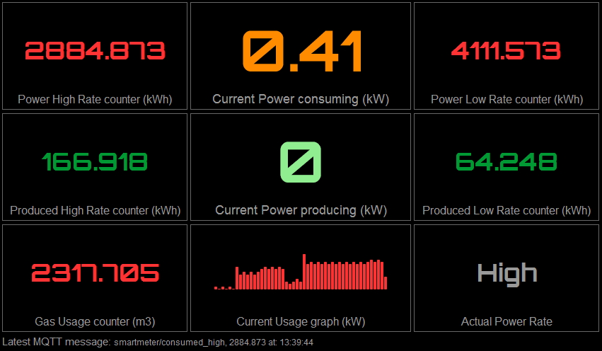

i have many Nodejs/MQTT/Websockets projects running now, but the first one who is presentable is the Node-js Iskra smartmeter solution.
I have a Raspberry connected to my smartmeter which sends the data via MQTT to the broker which is running on a Cubietruck http://blog.bwired.nl/?p=877
The Cubie is logging all the data to a mysql server which is also on the cubietruck and the Cubie is presenting this realtime smartmeter webpage with a realtime Graph
check out http://www.mijnsmartmeter.nl
A more detailed blog with sources can be found here http://blog.bwired.nl/?p=913

Looks very good, I love that updating bar diagram, :)
