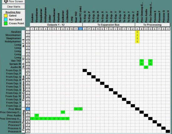

Here's the matrix again.
Connect the sound card to input 11 (Speech in) on the XAP800. Open up GWare and open the Input 9-12 screen and check the box next to the Post Gain meter to see if any sound is coming in into the XAP800.
Follow the same pattern as before. In the matrix connect Input 11 to Processor B and D by marking the crossings green. Next on the left find Processor D and mark all the cross point green to your outputs that are in use. You should have green boxes as shown in the matrx image above.

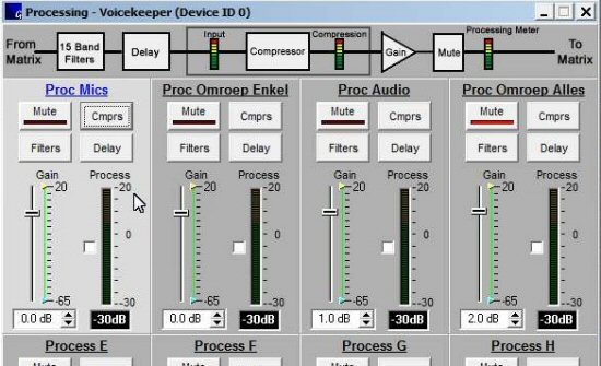

Open the Process A-H window and unmute all except Processor D. What you got now is one button to mute all audio (Processor C), one to mute single announcements (Processor B) and one mute button to mute all room announcements (Processor D). This will simplify the number of calls to make to the serial port.

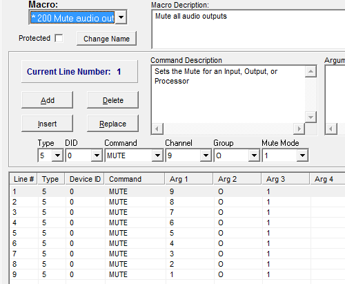

Open the macro editor in GWare.
Select macro 200 and fill the required fields as shown in the image.
Note: I have 9 rooms in use your number may vary.

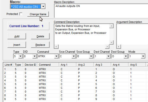

Select macro 202 and set it up as shown in the next image.
For the last one select macro 203 and fill it in just like the previous on but this time use a one for Arg 5 instead of zero

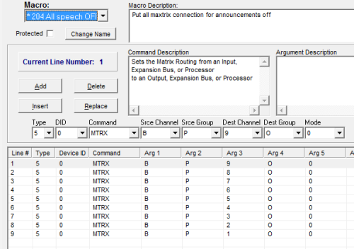

Macro 204 will be our last macro for now.
Create it like to image shown.

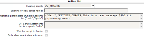

Make an event, trigger it manually and for the action select the script AZ_ZMC3.vb. Put this in the Optional parameter field
("Main","KITCHEN;OMROEP;This is a test message $$DS:W16 |2|warning.wav").
This will give you something like this.
I will explain this example.
"Main" is the function to call in the script.
You don't have to change this"KITCHEN" is the room name as you filled it in the INI file.
Next there must be a ; to separate the location from the command. The command here in OMROEP (Dutch for announcement).
Again a ; but now to separate the command and the parameters.
"This is a test message $$DS:W16" is the text to be spoken.
As you can see you can use the HS replacement variables here. In this case the string of device W16 is spoken.
Then you got a separator mark |
Next you get the volume. The example will put the volume at 2dB. Leaving it at 0 will not alter the volume level. Instead you can leave it blank also. This will do the same ("Main","KITCHEN;OMROEP;This is a test message $$DS:W16")
And for last you can also play a wav file before the announcement to get the listeners attention.
To speak an announcement to all rooms instead of the room name use the keyword ALLES (Dutch for All)
e.g. ("Main","ALLES;OMROEP;This is a test message $$DS:W16 |0|warning.wav")
