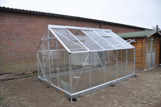

Problem is that I've got some other things to do tomorrow as well... like building a greenhouse:
2014-03-15 13.15.44s.jpg (40 KiB) Viewed 23963 times
So just be patient :wink:

I feel that there is something to do with Domotica in the greenhouse.
:D

Re: current scripts
Tadaa... 8)
I'll start a 'Greenhouse Automation' topic soon to hopefully get some inspiring input, cause I'm not the one with the 'green fingers' over here :lol:

I'ts looking like a real geenhouse.....My girlfriend and me both do not have green fingers, so no option for us.
Great job.....and looking foward to that automation as wel......can be done by one or 2 remote arduino's with a shit load of sensors. (temperture, humidity, watering system, lights..really everything)
