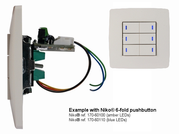

It's a Velbus module which requires only 4 wires (12V and Canbus).
I've been using the Niko 6 fold modules for quite some time now (http://www.domoticaforum.eu/viewtopic.p ... 356#p52356). Additional eletrical piping has been installed during my newbuild so i'm able to install low voltage wiring to certain locations which are mostly used for switching lights.
Until now an Aruino Mega with Marmitek XM10E has been capturing (or trying to capure) X10 messages for a few preprogrammed DAIX12's modules. ON or DIM switched 24v to the leds. The arduino and all additional hardware takes quite a lot of space and is hasn't been very stable. Lots of messages stay unnoticed.
Using velbus would be far more flexible and requires less hardware and cabling (4 wires instead of 14 (7for leds / 7 for switches). But how to send Velbus messages from Homeseer.
