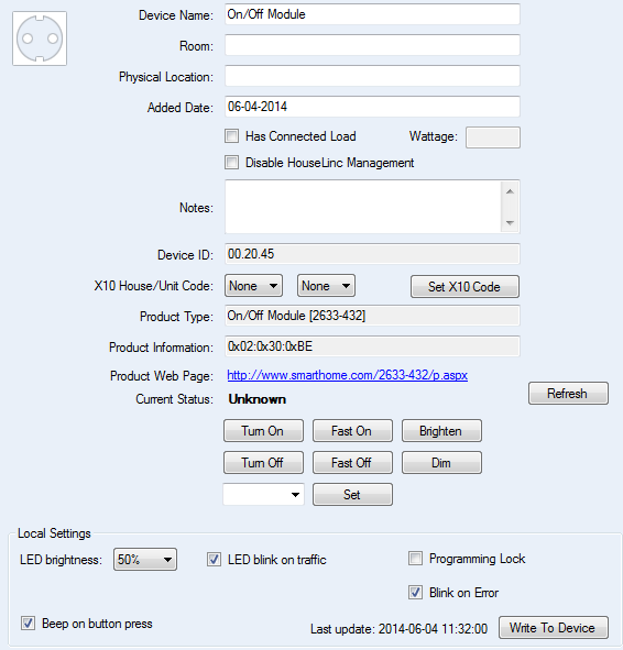

Below you see the properties page of an Insteon device from the HouseLinc software.
Insteon Properties tab.PNG (27.11 KiB) Viewed 13594 times
So you can give an Insteon device an X10 address.
It's also possible to add X10 devices to HouseLinc and control them with it:
Based on these screenshots I would think the Insteon interface should also receive X10 traffic, but I just can't confirm it.
