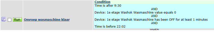

Re: Washing Machine - Ready
I do something like this.
Make virtual device and turn that On when your plugwise device > 4W and off when below that
Now you can trigger an event with the condition 'at least'
When you use a time of something like 20 min. it will cover the false trigger too for 'inweken'
The value equals 0 condition is there to trigger this event only once. In the action list of this event i set the device value to 50 so this event won't trigger again.
When the washing maschine is started again this value is set back to 0

I just made a similar setup but without the condition because it has hung up homeseer in the past, and therefore i`m not using conditions
