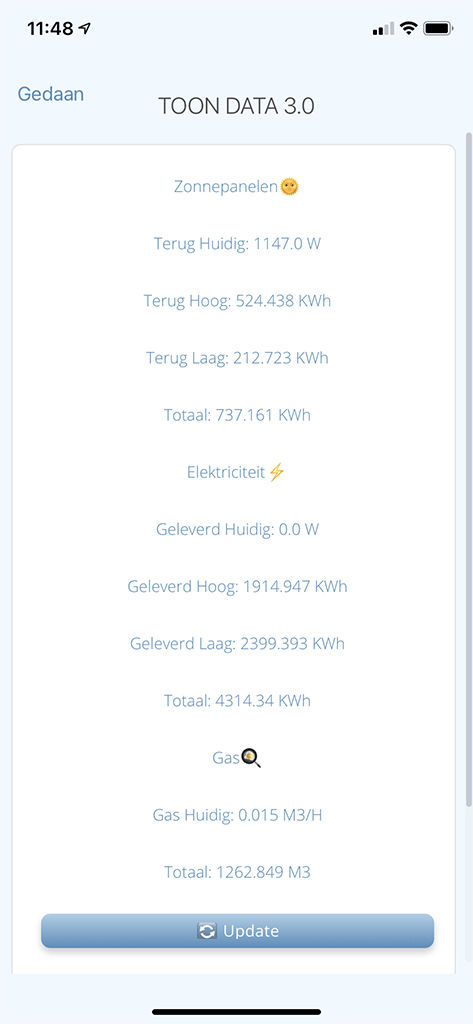

Both QuickApps will start updating within 1 minute and keep doing so every minute automatically.
All functions work like before.

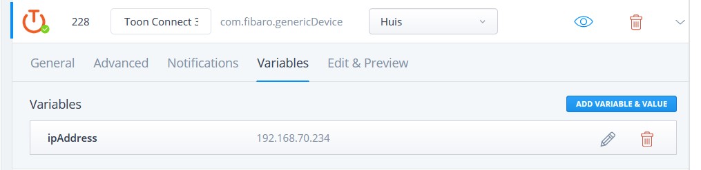

Just change the IP address for each QuickApp in the QuickApp Variables to the IP of your Toon and it should work:
Toon_Connect_3.1.fqa.zip

Toonconnect werkt prima, maar Toondata blijft leeg geen info.
Alleen ip aanpassen toch?
Groet Ruud

I have the same issue, toonconnect works perfect but toondata gives an error
[26.09.2022] [10:53:01] [ERROR] [QUICKAPP86]: QuickApp crashed
[26.09.2022] [10:53:01] [ERROR] [QUICKAPP86]: main.lua:34: attempt to concatenate a nil value (global 'ElecProduction')
