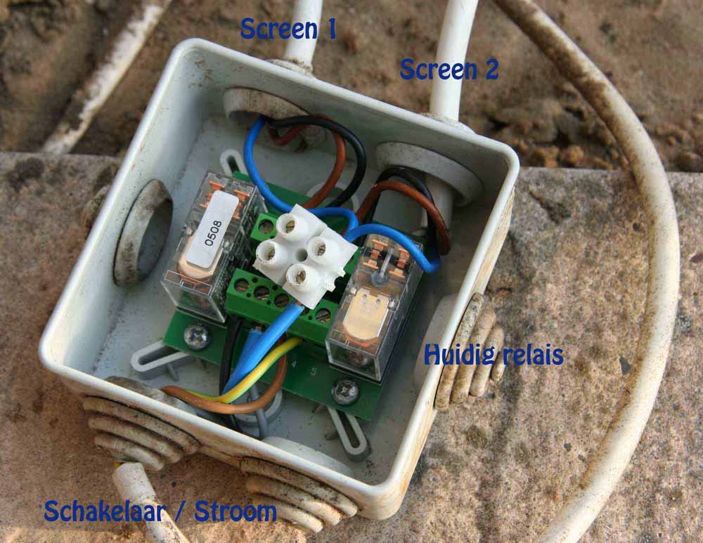

After having contact with someone from Merten I bought the 576398 relais.
In the picture attached the current relais is displayed (a LG 2119).
In my current setup there is however no distinction between the power connection and the switch. The Merten relais however (if I understand correctly) has one connection for the power and one for the switch. Does anybody know how to connect these?
