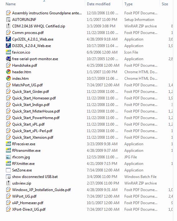

Just checked but couldn't find my cd.
However I've backed up all my installer cd's/dvd's.
In the attached picture I added a screenshot of the RFXCom directory, but couldn't locate the specific file you mentioned...

DeviceInstaller is Di32DL_4.2.0.4_Web.exe.
If you enable Autostart on the CD drive or open index.htm you will see the CD contacts with links.
