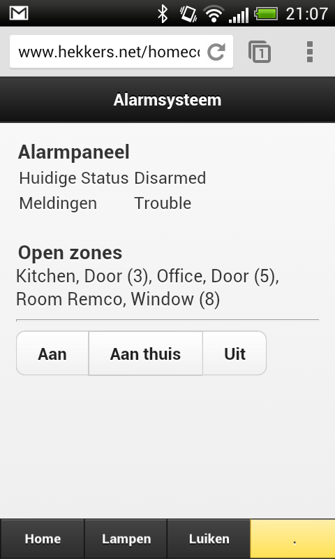

Re: Visonic and homeseer
Look here: http://www.domoticaforum.eu/viewforum.php?f=72&start=0
Based on http://www.domoticaforum.eu/viewtopic.php?f=68&t=6581 you should be able to control a Visonic Powermax.
I've even made a small interface on my smartphone for it:
2013-06-27 21.07.11.png (67.33 KiB) Viewed 7608 times
