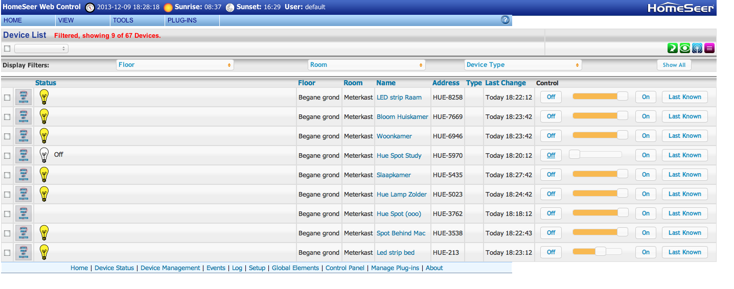

Here are some screenshots for the upcoming HUE HS3 plugin ….
Screen Shot 2013-12-09 at 18.28.10.png (164.06 KiB) Viewed 28555 times
Screen Shot 2013-12-09 at 18.28.31.png (39.72 KiB) Viewed 28555 times
Screen Shot 2013-12-09 at 18.28.43.png (49.77 KiB) Viewed 28555 times
1) It will automatically detect the lights and add then to homeseer
2) Support for multiple bridges (in my case there is a Philips HUE bridge and a Dresden Electronics) - each bridge can have their own api-key
3) Virtually unlimited custom presets (you can build a colour with your iPhone/iPad app and 'copy' to Homeseer
4) Pre-defined presets - 5 at the moment but easy to expand.
Todo
1) configurable bridges and username (api-key)
2) Event support with selectable preset.
Requires .NET 4.5 and JSON.NET

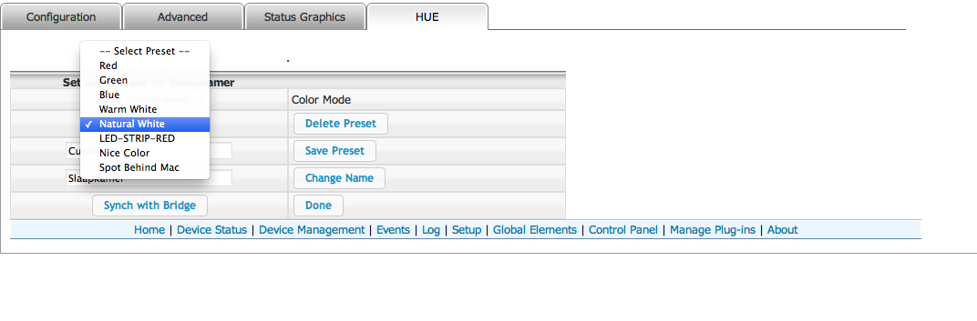

I added some more functionality, you can now set a device using a preset ...
