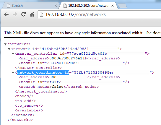

Whats does http://192.168.x.x/core/networks say?
Is there a "network_coordinator id" line in the xml output?
