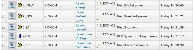

The Revolt NC-5462 can be used to measure the line voltage.
Problem with this sensor is that it transmits about every 4 seconds and a high risk that other sensor signals at 433.92MHz are disturbed.

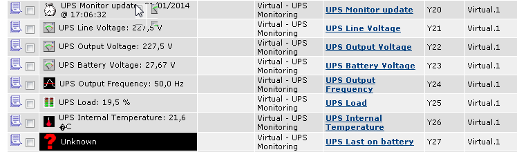

you can use a ups

@AKATAR...:
How did you manage to get the data in Homeseer?
And what UPS are you using?
I have a APC UPS, with a management card and graph the data with cacti

For this case you can probably use the Revolt NC5462
